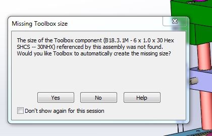

When opening assemblies I occasionally get warnings stating the component is not found, so I click OK and wait while it does something

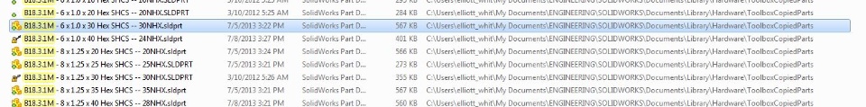

I looked into it recently and sure enough the part does exist, the path is set to look where we keep the copied parts, but I still get the error msg

Here's the message...
here's the component, just where it should be looking
