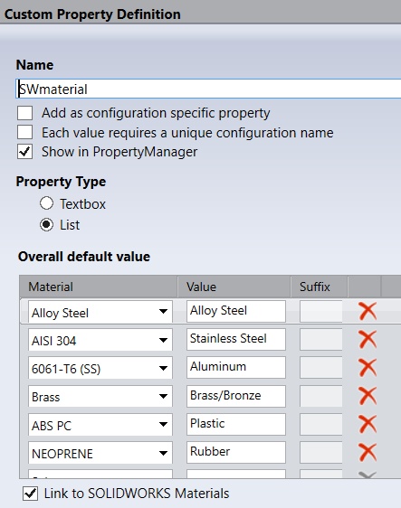

I'm not having success with setting the material of Toolbox components as they are created. I think it worked at one point yesterday, but now it is not.
I'm creating parts instead of configs. SolidWorks 2020.
The text is being added to Custom Properties, but I want the SolidWorks virtual material set for weight/density reasons.
