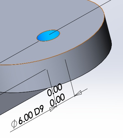

So, finally knuckling down and learning hole/shaft tolerances like I should have 15 years ago.
I want to specify a 6mm hole using the hole wizard with a D9. That should result in a hole with a diameter of between 6.03mm - 6.06mm. My issue is when I set hole tolerances using the hole wizard:
The +/- tolerance stays at zero. I am expecting the tolerance to calculate when I change the Hole Fit parameter from one setting to another. Am I expecting the hole tolerances to automatically be populated based on the diameter of hole and the selection I make.
My final hole callout ends up being +/- 0.00. Not what is intended:
Am I expecting too much or is the hole wizard not working for me?
