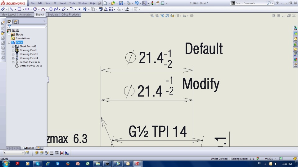

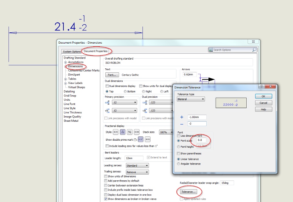

Drawing with specific tolerance in print sometimes when the distance between the numbers with symbols - or + is very close, so sometimes a symbol - or + as invisible, I've tried to find the settings so that the gap can be longer, while I made a manual for the specific tolerance . If there is a solution I would like to thank its settings.
