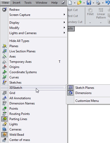

To turn off all the view display types I've wrote a macro. A part of it is:
boolstatus = Part.SetUserPreferenceToggle(swUserPreferenceToggle_e.swDisplayPlanes, False)
boolstatus = Part.SetUserPreferenceToggle(swUserPreferenceToggle_e.swDisplayLiveSections, False)
boolstatus = Part.SetUserPreferenceToggle(swUserPreferenceToggle_e.swDisplayAxes, False)
boolstatus = Part.SetUserPreferenceToggle(swUserPreferenceToggle_e.swDisplayTemporaryAxes, False)
boolstatus = Part.SetUserPreferenceToggle(swUserPreferenceToggle_e.swDisplayOrigins, False)
boolstatus = Part.SetUserPreferenceToggle(swUserPreferenceToggle_e.swDisplayCoordSystems, False)
boolstatus = Part.SetUserPreferenceToggle(swUserPreferenceToggle_e.swDisplayCurves, False)
boolstatus = Part.SetUserPreferenceToggle(swUserPreferenceToggle_e.swDisplaySketches, False)
boolstatus = Part.SetUserPreferenceToggle(swUserPreferenceToggle_e.swDisplayAllAnnotations, False)
boolstatus = Part.SetUserPreferenceToggle(swUserPreferenceToggle_e.swShowDimensionNames, False)
boolstatus = Part.SetUserPreferenceToggle(swUserPreferenceToggle_e.swDisplayReferencePoints2, False)
boolstatus = Part.SetUserPreferenceToggle(swUserPreferenceToggle_e.swDisplayReferencePoints, False)
boolstatus = Part.SetUserPreferenceToggle(swUserPreferenceToggle_e.swDisplayLights, False)
boolstatus = Part.SetUserPreferenceToggle(swUserPreferenceToggle_e.swDisplayCameras, False)
boolstatus = Part.SetUserPreferenceToggle(swUserPreferenceToggle_e.swDisplayCenterOfMassSymbol, False)
boolstatus = Part.SetUserPreferenceToggle(swUserPreferenceToggle_e.swGridDisplay, False)
So most of the display types will be turned off, except the "3DSketch", "Parting Lines" and "Weldbead". Does anyone know a solution for this?
