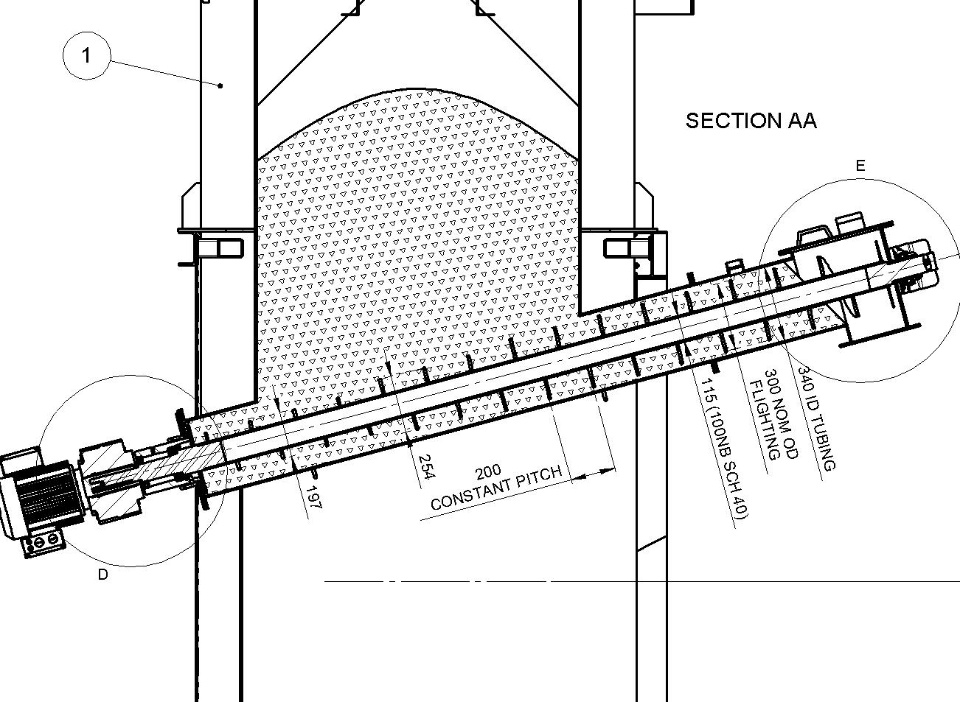

Hi all.
I have an assy of a wood chip bin with 2 augers in the bottom. The bin also has the chip in it.
When I produce my drawings Im trying to show a sectional view.
That parts easy enough but because I'm sectioning through 1 of the auger centerlines the flighting is hatched both as wood chip and steel. This is due to the fact that I havent subtracted the auger flighting from the volume of the wood chip.
Easiest way to resolve that is to subtract the volume occupied by the flighting from the chip, but how?
