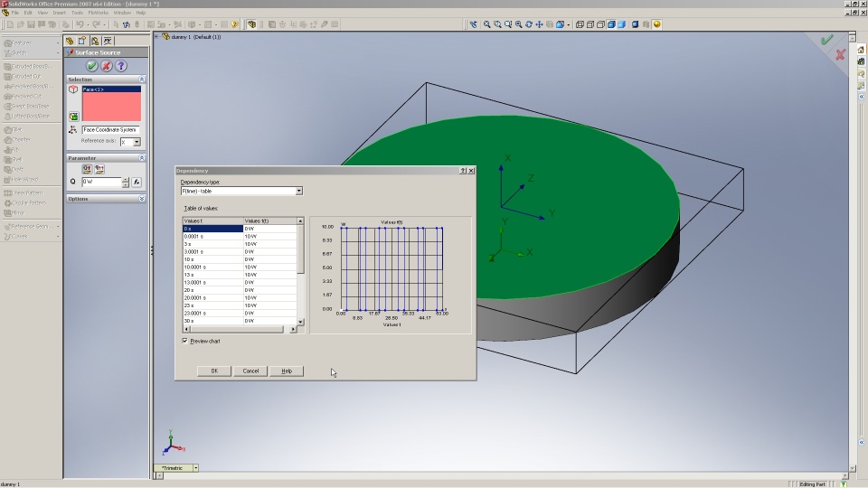

I have read the help files and am not sure if I am setting up my problem correctly.   My problem is as follows:
I want to pulse a surface heat source; on for 3 seconds and off for 7 seconds.  I want to simulate one hour of operation or until the solid temperature has reached steady state.
I have set up the problem as follows:
General Settings:
      Time Dependent: checked
Calculation Control Options:
     Finish Tab:
           Finish Conditions:
                Maximum Physical Time:
                     Value=3600s
Heat Sources:
     Surface Source:
           Toggle:
                Dependency: f(x)
                    Dependency type: F(time) - table
                         Table of values:
                              value t          Toggle
                                   0 s          On
                                   3 s          Off
                                   10 s        On
Does this correctly simulate the pulsing of my surface source 3s on, 7s off, for 1 hour?
