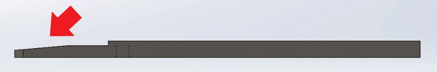

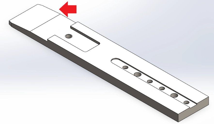

I'm trying to create a three-axis feature in just the region below:
This is the side view:

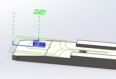

I created a new multisurface setup and selected the top face, but the machining does not follow the multi-surface feature:
Is it possible to create the multisurface feature for only that region?
