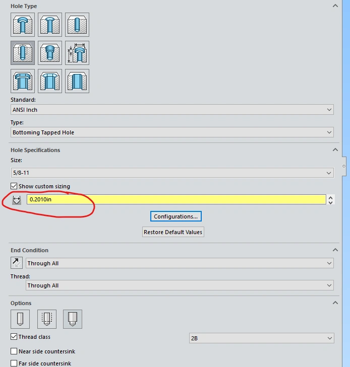

How do you get a threaded hole, pilot hole size into a design table when you select through all for the end distance. If I create a part from scratch with a threaded hole and make a couple different configs then change the hole sizes then insert a design table it adds the hole size, thread diameter and thru tap drill depth but no tap diameter.
If you change the hole to a blind depth, then it will add it because it adds a dimension in the hole sketch to do that but with it set to Thru then that dimension isn't there.
On my original part whomever created the one I copied made the pilot hole size the same as the thread OD by choosing the "show custom sizing" option and typing it in i guess?
All I want to do is get it back to using the default sizes but if I select for all configs it makes all the holes the same size as well as the pilot hole. So, I then went through and changed each hole size in the design table and that set them to the correct OD, but all the pilot hole sizes are the same size.
This part has 304 configs and 4 different threaded hole sizes spread out amongst those configs.
I could go through each config, edit the hole feature and select the "restore defaults" button but that would take a long time.
Another possibility would be a macro which does what I just said above. But I would have to figure out how to do that.
I was hoping I could just set it in the design table since I already use one in this part, but I can't figure out what the column header is for that dimension/property.
