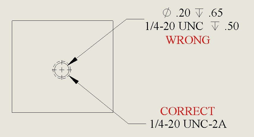

thread callout-leader location
Which leader location below is correct?  Having the discussion at work but lack the ANSI/AMSE standard.
