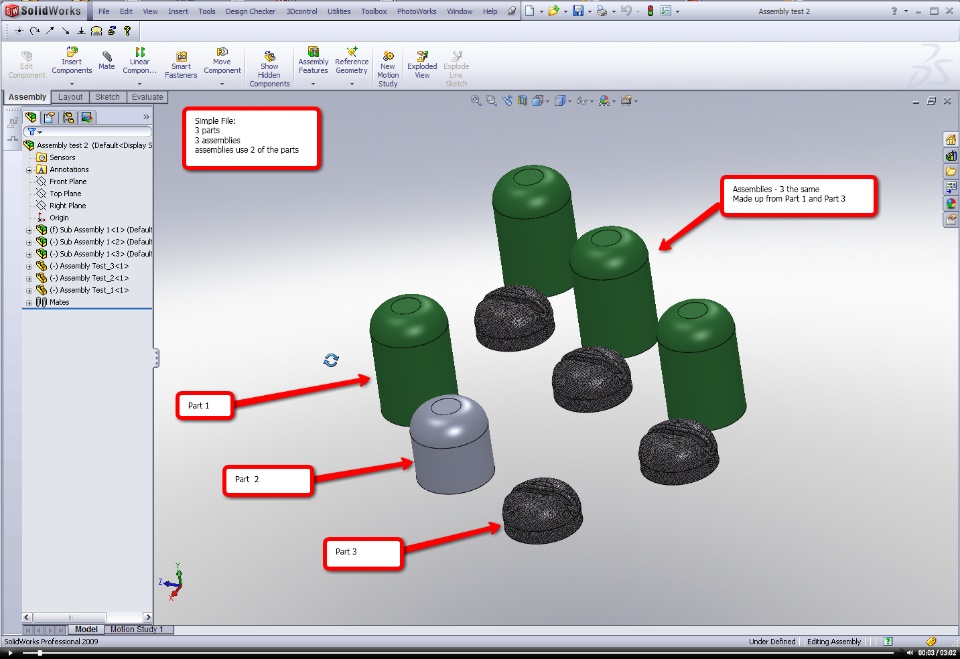

In the current version there are a few things that I havefound can be a bit of a stumbling block when it comes to setting uprenders (particularly anything complex).
1. PV360 doesn't obey the saved show/hide status of assemblies -everything is on display when you open the file. (I am nearly 100%sure this was not the case in the beta phase?).
2. When you hide elements it hides things on a root level basis inthe assembly. For example if your assembly has parts and subassemblies, if you click on a part inside a sub assembly and choosehide - the entire sub assembly is hidden. The selection of entitylevel makes no difference here.
3. Worse than 2 though if you have duplicates of the sub assemblyand you click on one to hide - they all get hidden.SolidworksPhotoview 360
