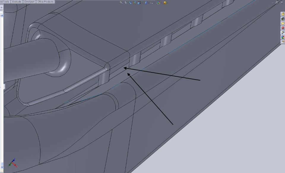

I have created an 0" offset surface from the two surfaces shown with the arrows.  I then am trying to create a thickened cut using this offset surface.  It will let me create a cut that is .002" thick, but not .0002" thick, so from my ProE days, that would indicate an accuracy adjustment would be required.  The pins shown in this are only .02" in diameter so I'm not trying to get many orders of magnitude of relative accuracy here.  Any suggestions?
