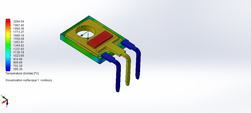

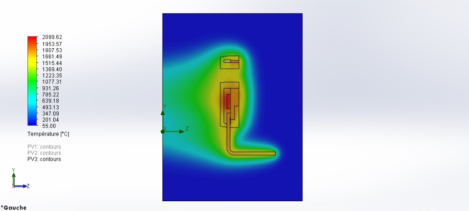

I am trying to model a TO-247 transistor on a heat sink.

For the bonding material I have no idea...so the only way to define it should be through a contact resistance between the case and the junction....
If I choose to use material/thickness definition I have to approximate chip material&thickness.. so I do not know if it will be accurate.
The problem is that I do not know how to convert the RTH junction to case given by the manufacturer data sheet (°C/W) and the Contact resistance required in SW Flow simulation which is in K*m^2/W ...
