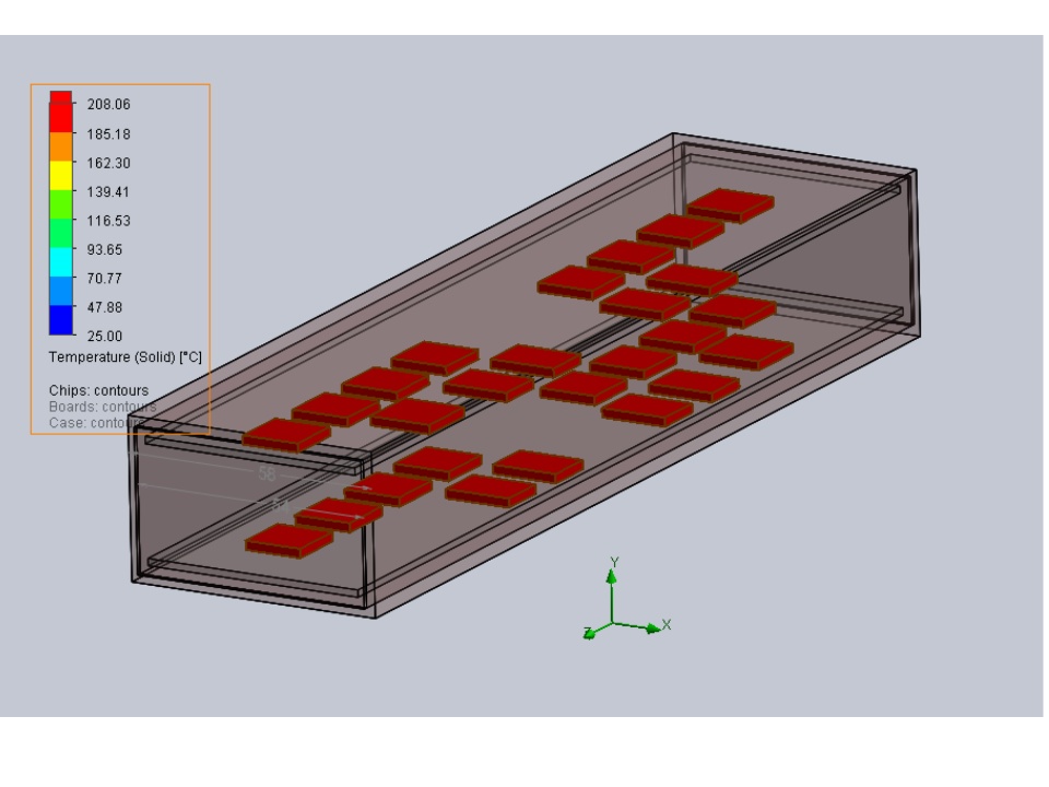

I am trying to simulate the heat flow in a system and the temperatures that I get for the fluid in my system do not match what I expect them to be.
When I expect to see a temperature rise of 3 degree Celsius, I only see 0.6 degree Celsius. When I expect 120C, I see a 21C.
My system is pretty simple: There is a copper box (with adiabatic outer walls) in which there are two FR4 boards (facing each other) (the boards are 2 mm away from the inner walls of the copper box). Each board has 13 chips (chip material = Typical CeramicBGA) on it and they are defined as volume sources (12 of them = 0.5 W and 1 of them = 1W). There is an inlet lid through which water flows in with a volume rate of 0.001Kg/s and temperature 17C and an outlet lid which is set to the standard temperature (25C) and standard pressure. So, everything looks good.
When I run the simulation, I see the water temperature go from 17C (average inlet temp) to 17.48C (average outlet temperature). I should see a ~3.39C rise (17 to 20.39 approx.), but I dont see it!

I have attached a picture of the system for better visulaization of the problem. Please ignore the temperature on it.

Are you chip temperatures remaining where you expect?  I would assume if your water is not getting as hot as you expect it is because you are not transferring all 14W into the water.  If this is the case your chips will continue to heat up until the heat generation matches the heat removed by the water.
SF
SF 2013-08-12
Karishma sent me his model, he thought that the heat inputs were per component vs total. So all components were selected and 0.5 applied, so it was like 15/0.5W instead of 15x0.5W.
SF
SF 2013-08-12
Yes. Fixing the power fixed it. Thanks alot!
