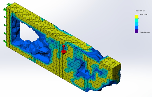

I would like to create a part with minimized material but with an FOS of 2, the possible design space looks like this
The material of use should be 1060 Alloy, the external loads should be gravity downwards and additionally should a 20 kg mass be placed on the small face on the topside. It is highlighted at the next screenshot
As a goal I select "Minimize Mass", "Stress/Factor of Safety Constraint" and set the Factor of Safety Constraint to 2, as shown in the next picture

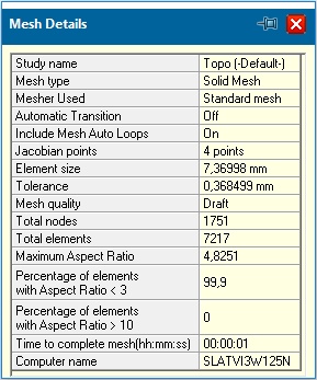

For the mesh, I used a coarse Standard Mesh, because I just want to get an quick overview. Here you will get also the mesh details of my study

at my opinion it doesn't look like that a proper convergence was reached, so I went to the study properties, advanced and changed the maximum number of iterations to 100. Afterwards I run the study again but with the same result. What ever, I took what I got, so the result plots look like the following ones

After the change I created a new static study with an FOS plot. This plot shows me where I need to insert more material so that the whole part has a minimum FOS of 2
So now I’m interested what do you say to my way?  Would you do it the same way?
