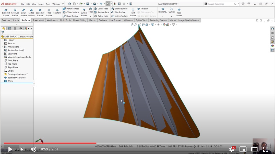

The challenge is very simple: Approximate a complex shape with a series of planar facets, similar with what the Loft Bend desired functionality in the Sheet Metal Module.
If we, as a Community put our minds together, we might be able to formulate a pretty good solution that SOLIDWORKS might write it as a tool in a future version. This will be very useful for many designers from various industries.
Challenge:
1. Watch this video (also attached):
2. Download the attached Parasolid file and open it in SOLIDWORKS
3. Formulate a method for creating an approximation of the imported surface, containing only planar faces
Mandatory criteria:
For solutions using only 3 edge facets (triangular facets):
  1. Each facet can have its vertices located only on the edges of the imported surface.
  2. The facets can be knitted in one surface body with no gaps between facets
  3. You can use any tools you want, including API features, as long as the final result is a SOLIDWORKS model that could be edited by the user.
  4. If you use macros or API features, the code will be published and "donated" to the SOLIDWORKS Community.
For solutions using 4 edge facets:
  1. Each facet can have its vertices located as close as possible to the edges of the imported surface.
  2. If the facets were to be thickened outward, the gaps between them would be minimal and there would be no interferences.
