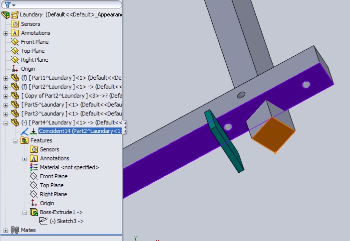

I design top down and made Part 4. Floated it.
Now made a coincident mate between the faces shown, but you can see they are not.
I can move the part freely in all directions.
I have changed the plane of the sketch from the assembly front plane to the part's front plane and it worked.
What's the difference between the planes?
