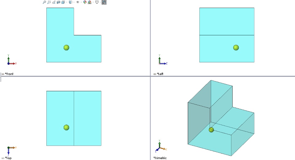

During the first WPUC, we found out the need for boundary mates. What about volume mates? How can you limit a component's movement in a given volume, while preserving all other degrees of freedom? Let's think about that this week.
For eternal glory and 1000 points, provide the best solution to this problem:
  1. Watch this video: SOLIDWORKS 7th Weekly Power User Challenge (June 2nd, 2017): Simulate a Volume Mate - YouTube
  2. Download the attached files Prisoner.X_T and Jail.X_T
  3. Convert both to SOLIDWORKS format
  4. Start a new assembly
  5. Insert Jail ​in the assembly, fix it and make it virtual
  6. Insert Prisoner in the assembly and make it virtual
  7. Create a mating scheme that would keep the Prisoner confined in the Jail.
  8. The Prisoner can go anywhere inside the Jail
  9. Upload the final assembly (with virtual components, please) by replying to this message.
