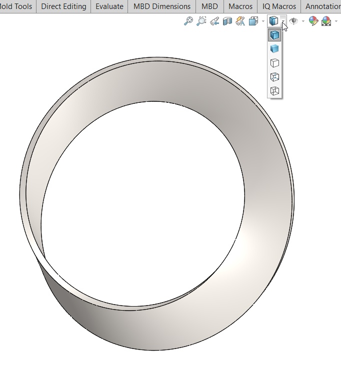

It is very simple. Create and upload a SOLIDWORKS model containing one solid body with 2 faces depicting a Möbius strip.
The first person to upload a model created using SW features (no Imported Geometry, please) will be awarded 5,000 points and as much beer he or she can drink at the 3DEXPERIENCE World 2020 (valid attendee pass required).
Notice in the picture below that the display style is Shaded with Edges, and only 2 edges are visible:
