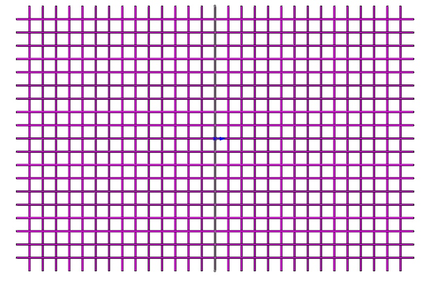

1. Imagine a grid of rods welded together:

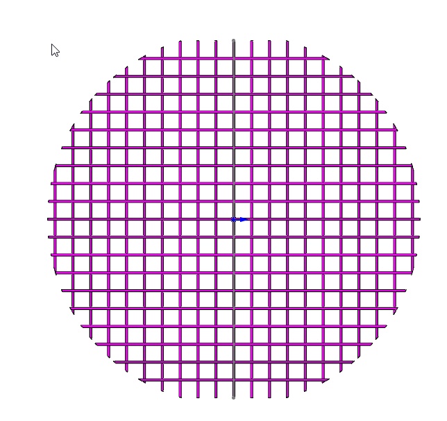

2. Cut them with a shape (anything inside a sketch). Example - Circular cut:

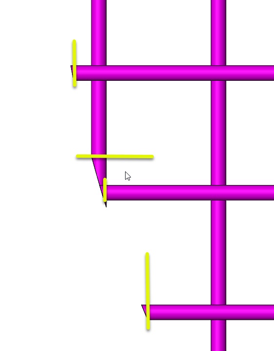

If you check the ends, the end-faces of each rod are no longer normal to the axis of the rod:

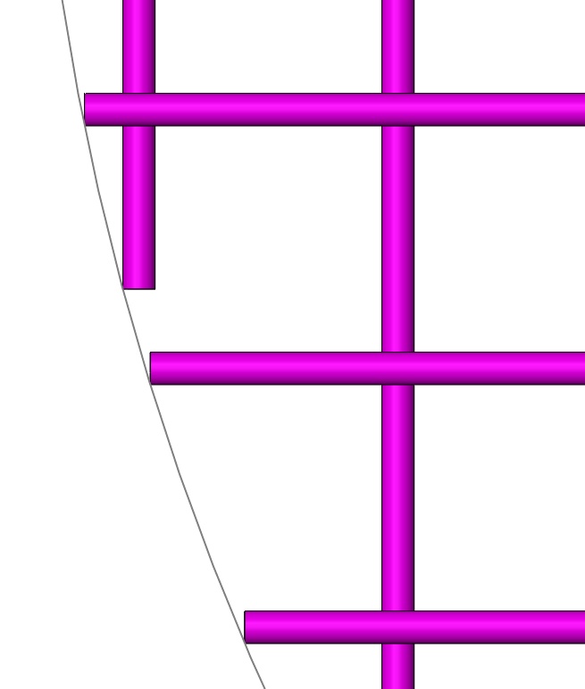

What if the manufacturing process goes as follows:?
1. The rods are pre-cut to size before being welded. All faces are planar and normal to each rod's axis.
2. The length of each rod is based on the minimum material condition after the cut:
3. When the rods are welded in the desired pattern, they are touching the trimming sketch in at least one point.
It will look like this:
