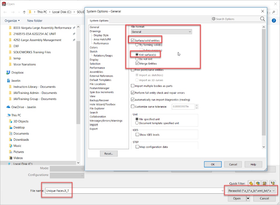

- Use these options for importing the file in SOLIDWORKS. We need a surface body as the result.
3. Resolve any topological errors at face level. Gaps are acceptable.
4. Using only SOLIDWORKS features (exporting out as a neutral format (or other type of format), and importing it back, with the option to not knit faces is not acceptable) "unknit" the existing surface body in such a way that would generate individual bodies.
