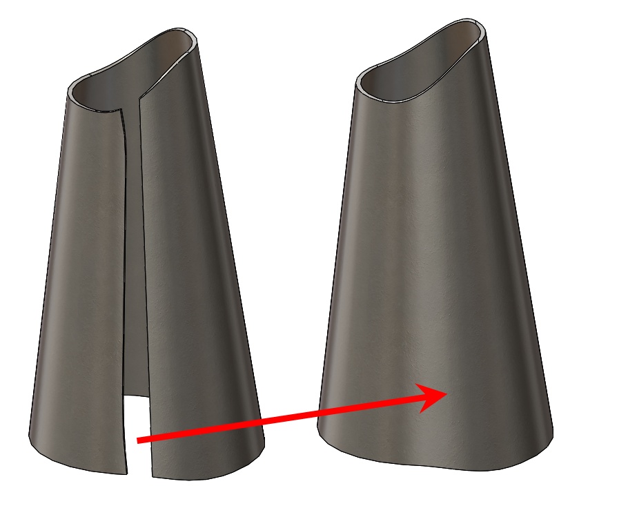

This is a very easy challenge, so there will be only 1 (one) 5,000 point prize.
To win it, find the simplest, most elegant solution (yeah, I know, it is a subjective criterion) to this problem:
Remove the slit from the attached file.
Speed is not essential to winning this challenge.
Please submit your entries before Friday, the 17th of November, 5 pm ET.
