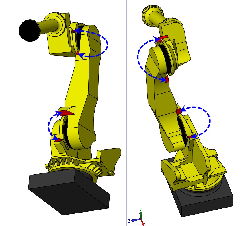

This week I propose we focus on the flipping angle mate problem, and especially on workarounds to simulate the functionality of angle limit mates.
As a case study please download the simplified assembly of a 3 axes articulated robot. If you have SOLIDWORKS 2015 or newer, you can download the assembly file, otherwise, please download the Parasolid file.
The challenge is very simple and you can win up to 10,000 points
1. For eternal glory and 5000 points, be the first to mate the base in such a way that it can rotate +/- 185 degrees. The mate has to be as stabile as possible during move/rotate, suppress/resolve operations, configuration changes and other manipulations. Upload the assembly file in this thread.
2. If you are not first to provide a valid solution to point 1, hope is not lost. If your solution is valid and significantly different you will win 1,000 points. To clarify, I will use my discretion to award these 1,000 point prizes, using subjective criteria that are not worth discussing here.
3. For eternal glory and 5000 points, be the first to fully mate the robot. To further simplify the mating scheme, please use the red faces as visual references for the rotational limits. It does not happen in real life, but in this case we will pretend that the red faces will touch at extreme positions. Upload the assembly file in this thread.
