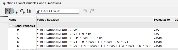

For custom properties, I have a wilder workaround.  It works, but genuinely... I felt insane coming up with it.  I first create a series of Global Variables for each of the digits:
Each of these Global Variables can then be used in a Custom Property:
XYZ-"H@model.SLDPRT""T@model.SLDPRT""O@model.SLDPRT"."N@model.SLDPRT""D@model.SLDPRT"
It's a pretty wild workaround, but so far it's worked for what we want to use it for.  I don't have a method for how to do this sort of thing exclusively within the Custom Property interface.  You need a set of Global Variables or a Design Table to do any amount of numerical text formatting, which means (as far as I know) we can't do something like this to Weldment Cut List properties.
