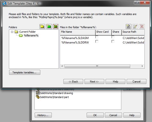

I'm trying to create a few templates that people can access via,(inside PDMWorks) right click ->new->SolidWorks->New XXX.
This works fine for normalt empty templates, assemblies, drawings, parts etc.

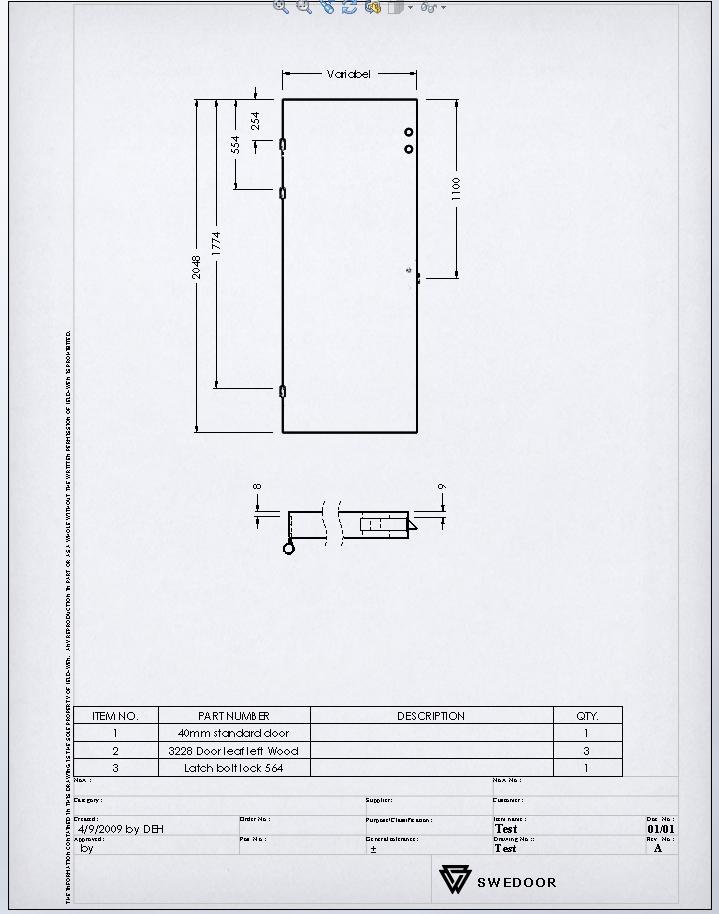

But I would like to create a single template for two files, an Assembly and a Drawing.
This seems to work just fine! Until you take a closer look at the referance on the drawing, all the views referance to the main assembly, not the one copied from the created template with PDMWorks:
Is there anyway to get the newly copied assembly to referance to the drawing? Without using "Copy tree"??
