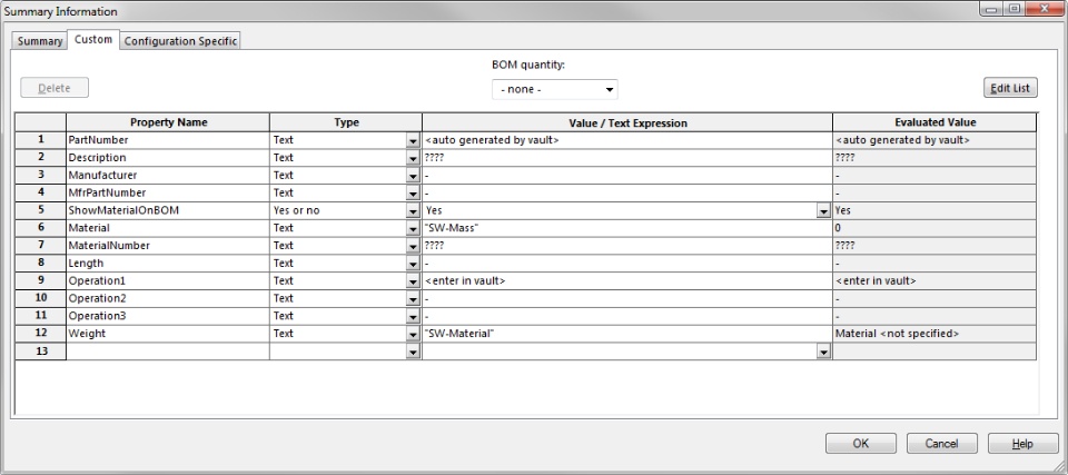

Here are my current part template custom properties:

"Solidworks material" and "raw material numbers" -  The solidworks material library is in groups and has all the alloys we use.  But erp needs specific raw material sizes (ie L4x4x3/8), each with its own part number.  Not sure how to best set these up.
Manufacturing method -  Parts may be cut, machined, purchased, etc.  Thinking about adding solidworks attribute(s) for this, that gets passed into erp.  Not sure.  This might be input easier somewhere else, not in solidworks...
Location of attributes - I think the part and assembly attribute lists will be identical.  Weldment cutlist item properties might have to be the same... but this seems like a lot of extra work.  Thinking that drawing attributes will be minimal, with just the info that needs to go on the title block; all driven from the part.
Numbering attributes - Currently we just have a "PartNumber" (our internal) and "MfrPartNumber" attributes in the part custom properties.  Anyone else just use these two attributes?  The pdm guys recommend having different numbers for parts,models,drawings, etc... seems complicated.
Custom/configuration specific properties - some of our parts use configurations.  Not sure what to do here, or if having the data stored in two places might cause problems.  Would hate to have to redo everything later because we didn't understand this!
