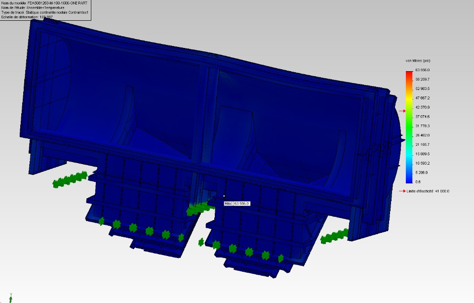

Hi,
I have a big duct made of steel ASTM A-36. When it is working the maximun temperature is 170C. I use 22C as initial temp. The problem that I have is the high stress generated in the supports. I have tried to fix the supports if differents way and it is impossible to find good values of stress. Please, if somebody has a solution for this issue, I will appreciate.
thank you
