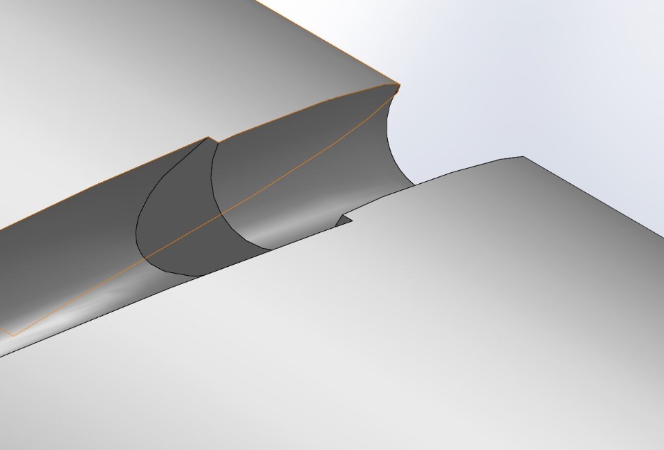

I have a part that has been giving me some issue when I go to use the cut sweep feature - upon searching the web - I've come across a couples posts which hint that possibility that the tool is a bit buggy - I was wondering if anyone could shed some light on this -
To explain what I am doing - I have a part (a pen cap) which I want to scribe some lines onto for aesthetic treatments. I have gotten the cut sweep to work - however upon closer inspection I have noticed that the path is irregular and I am getting some strange faces in the cut (see photos attached)
This is not an overly complex part or operation so Im a big baffled. To explain some of the process and detail that I've gone through to arrive at my design intent:
- Cap is a triangular profile
- To get the path for my cut sweep I have created my sketch - projected it onto the cap and then created a 3D Sketch from the generated profile.
- I then created my cut profile (in this case a circle) to use with the 3D Sketch
- I can get this to work but depending on the settings I get some very strange results - the profile does not always follow the path so the cuts become irregular.
- In the instance where I did get this to work - I get the irregular faces in the cut path; if I go to try to correct this with replace face or similar feature, I get a crash.
Does anyone have any insight into why I might be getting this issue? is it a bug in the tool?

Can you post your model?  Or a model that shows the issues you are having?
Use the Advanced Editor link in the uppoer right of the dial og box.

Hi Anna -
See attached - the file has the swept cut with the issue I've mentioned in my previous post.

Hi Leonard,
If you select "Faces to Pattern" it seems to work.
MK
MK 2013-11-11
If you do half of the swept cut, cut your solid body in half, then mirror this half of the body, it will also work.  You can combine the bodies also.
Not sure what's up with the swept cut not working though.
AW
AW 2013-11-11
Seems like a bug.  I would submit this to your Reseller so they can get it to SolidWorks.
May have do to with how you are constructing your path.
Another option is to use an Intersection Curve instead on a 2D Sketch plane.  Do this in place of the Split Line and 3D Sketch you are doing now for your Path.
Turn the Intersection Curve into a construction line, then do a Fit Spline on that intersection curve.  Constrain your circle sketch to the Fit Spline. Use the Fit Spline as your path.
See attached.  There is a folder called Anna's Take with the features I used to construct the cut.
