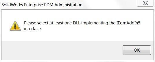

The addin is compiled in VS express 2012 using .Net Framework 4.
I read that the pdm does not support .Net 4 but that is the only target framework I could install. Compiling as .Net 3,5 just gives a error saying that the "dll does not implement IEdmAddIn5 interface", is it a glitch in the documentation or do I have to do something else to be able to install a .net 3,5 *.dll in epdm 2013sp2?

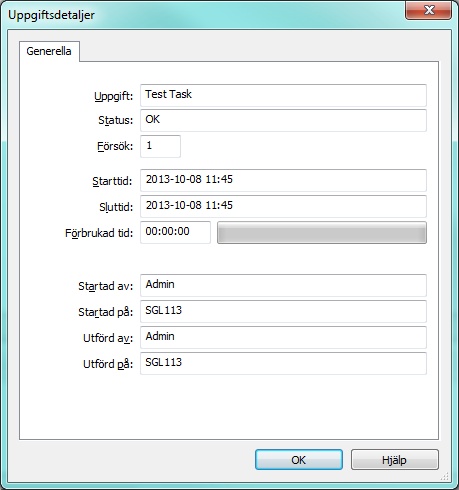

This is how task properties should look according to the sample:
For me the scheduling page and the custom add-in page is missing
This is how task details should look and how it looks for me (custom task details tab missing):
