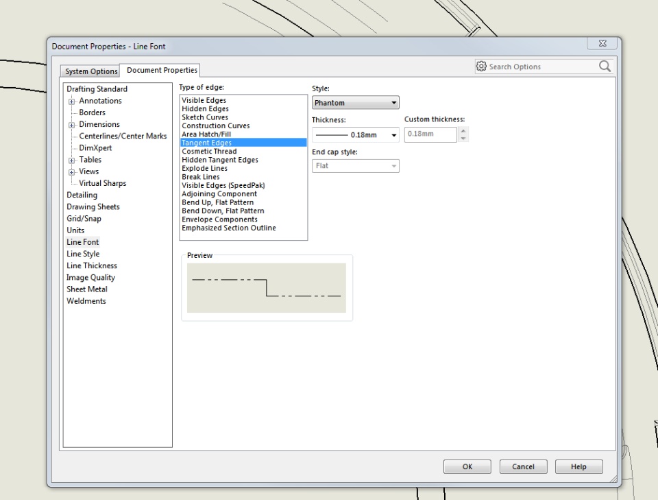

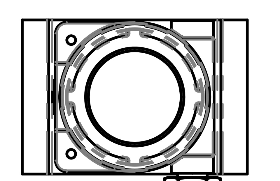

I have an issue when it comes to tangent lines in on drawings. We normally set our drawing views to display as "Tangent Edges with Font" where it shows tangent edges in grey, phantom lines. This works well enough in the drawing but when we save as PDF, the tangent lines always show up on top of the black visible lines. In some drawing views with many tangent edges, this causes quality issues when printing full size drawings for construction (it just looks funny/bad).

1) The ideal solution would be a "draw order" function where I can set visible lines to print over top of tangent edges; however I have never found an option such as this.
2) Another solution would be to make the tangent edges much thinner; however they are currently sent at 0.18 mm and I believe this is the minimum limit for SW.
