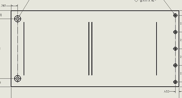

my preferred style when creating drawings for parts is to use tangent edges displayed with the ends hidden. this is easy enough to enable, just right click on a view and tangent edges > hide ends.
however i feel like SW is cutting too much off the ends, creating some ambiguity. see the attached screenshot. i cannot find any option to define the size or ratio of ends that are hidden on tangent edges. anyone know of an option i missed or a way to display tangent edges clearly without resorting to full lines or tangent font (which i also feel can be ambiguous at times).
