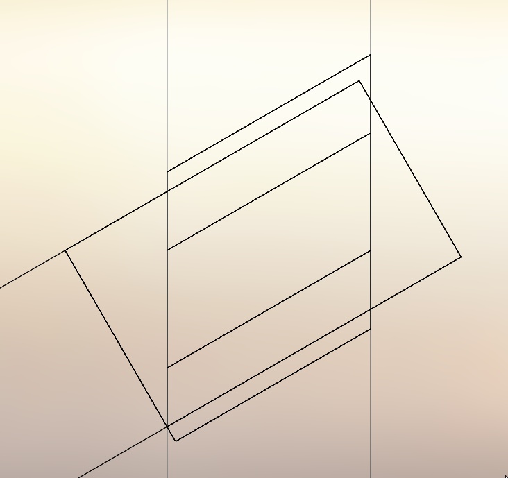

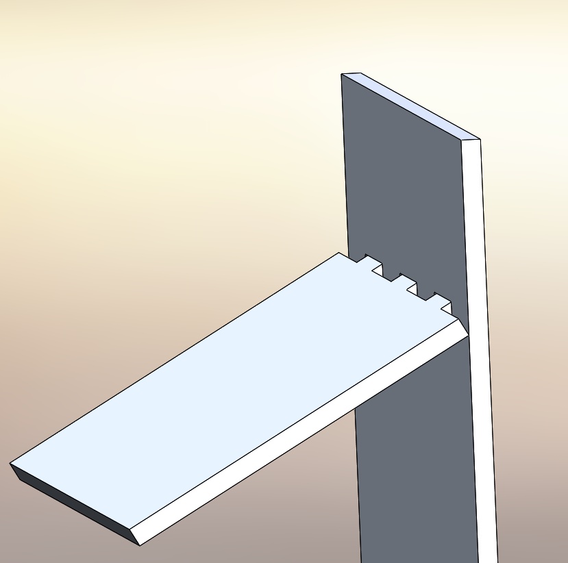

However we have found that when the two sheet metal bodies/ parts used for the feature are not perpendicular, the slots are cut at an angle.
I think that tab and slot needs a "normal cut" option, or has anyone else found a good way of achieving this? (I don't consider selecting all those surfaces and using "normal cut", or performing additional cuts, to be a good way.....)
