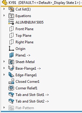

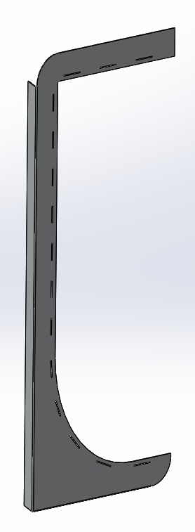

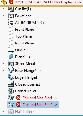

Here's a part (attached, see screen shots) with tab and slot. As you can see none of the features are failing. Flatten it with sheet metal tools>flatten and it's all good. However as soon as you create a derived config, (i.e. for flat pattern) , the tab and slot features fail.
I use two plug-ins (NESTINGWorks and CustomTools) to export cutting profiles/ dxf's, and the tabs & slots are missing on the exported files. I've tried locking/ breaking references and nothing helps. I really need to use these plug ins, as they save hours of time. I can't afford to export every sheet metal part "by hand".
