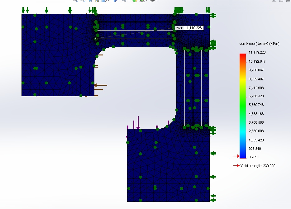

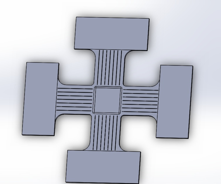

So I've tested a biaxial  cruciform specimen of SS304, it yields at about 3000Newtons. Now according the the test machine it yielded when the combined force on the x axis was 3000, pulling both sides. The  y axis about the same.

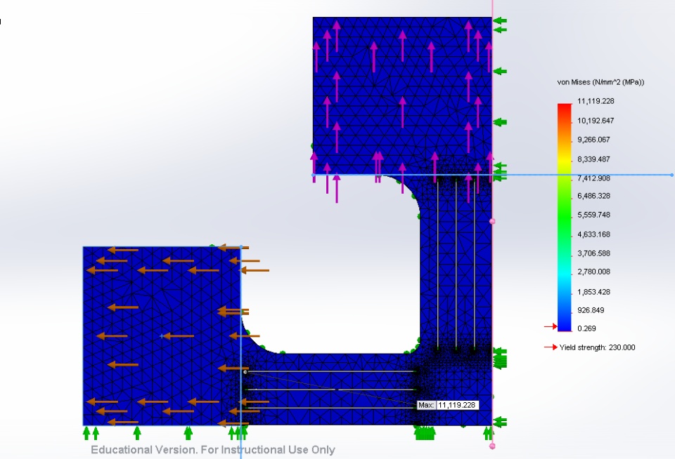

To simulate, I've cut the specimen in four, symmetric, and then in half again as it also symetric that way. You'll see this in image.
This leaves me with only two places left to apply force. What force should i apply here to mirror the 3000 on the x and the the other 3000 on the y, I'm a bit confused as to which way solidworks does this.

Assuming the body is not sliced in half parallel to the plane in which it resides, it should be 750 each gripped surface (assumes quarter-symmetry). After a run, check the reactions on the restrained (symmetry) faces and they should be 1500 each orthogonal direction. Hope that helps.

I disagree with Anthony. If I'm understanding everything correctly, the test machine pulled 3000 N vertically and 3000 N pulling horizontally. This means there was 3000 pulling up, 3000 pulling down, 3000 pulling left, and 3000 pulling right. The force to the left does not add to the force on the right. 3000 left + 3000 right = 3000 static. If you use 1/4 symmetry, you should have 1500 N pulling on each half surface. You could also take this model to 1/8 symmetry by cutting it diagonally. It would still be 1500 N on the remaining half surface.

Sorry I should clarify, it's a total of 3000N on each axis, so average of 1500 being pulled on each. Also it's 1/8 model as I halved it through its thickness aswell as quartering it

A quick test is to query the reactions and it will tell you the loads along each axis.

Whoops. I missed the split the last way. Anthony is right and I am wrong. So, If you have 1/4 the top surface left, then it needs 750 N.

1/4 symmetry in each direction = 750
use reaction forces to check

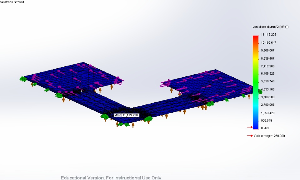

What about for 1/8, as I've split down thickness also

you're using an 1/8th symmetry model
but in one direction you really only have 1/4 symmetry.
might be worth drawing out the progression to just make it make sense

The bottom line is keep the pressure on the loaded surfaces constant. So the load you should apply = 3000 N * (the remaining fraction of the loaded surface). If half the surface is left, put 1500. If 1/4 is left, put 750. You don't have to worry about symmetries and such, you can measure it directly .
