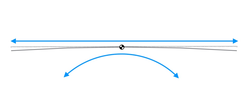

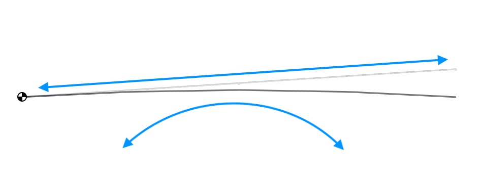

Please see the attached images. I want to be able to unfold this part so it is parallel with the horizontal plane. The default result is as shown in Image 1; pivoting from one end so the flat pattern is on an incline. I want it to flatten from the central point symmetric about the vertical plane as per Image 2.
Is there a way of modelling this so that the flatten or unfold results display as I want?
