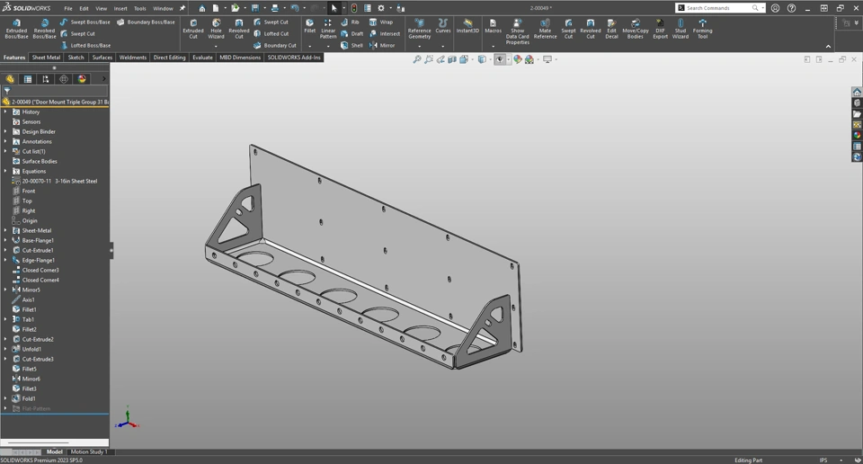

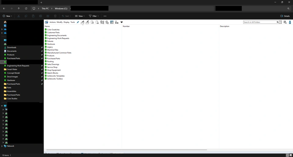

On the laptop workstation, everything is scaled correctly, INCLUDING SolidWorks and PDM. When we go to the conference room and connect using Windows Remote Desktop Connection Application, the scaling of SolidWorks and PDM is EXTREMELY small and unusable. Its as if the scaling is not updating, or is updating to the new resolution of the remote connection/conference room setup monitors. We recently switched our conference room PC to run the remote connection from a laptop running windows 10 and had no issues with this scaling or any other issues. The problem arrived when we switched to a windows 11 "Mini PC"

Laptop Workstation:
Lenovo ThinkPad G7 - Windows 11 Pro
Lenovo Dock Station
x3 LG 32in monitors @ 1920 x 1080 (100% scale)
*Example of normal/default scaling on laptop workstation setup shown below:

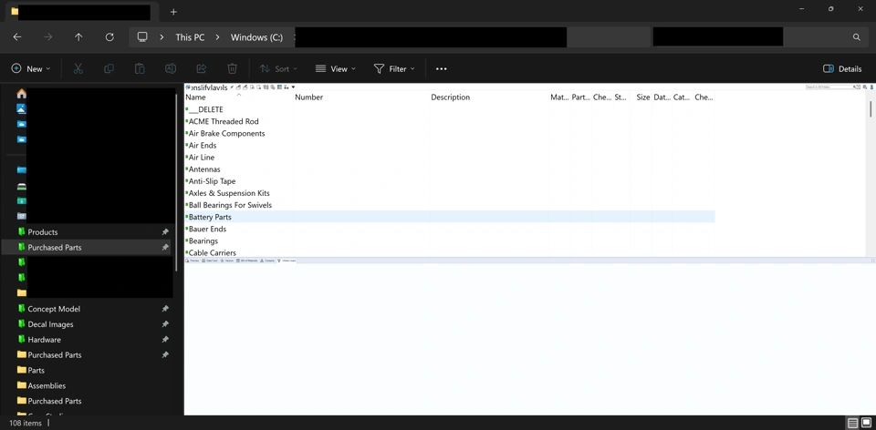

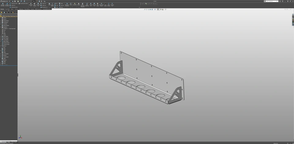

Conference Room Setup:
Mini PC - Windows 11 Pro
x2 65in monitors @ 4096 x 2160 (300% scale)
*Example of scaling issues on the remote connection conference room setup shown below:
