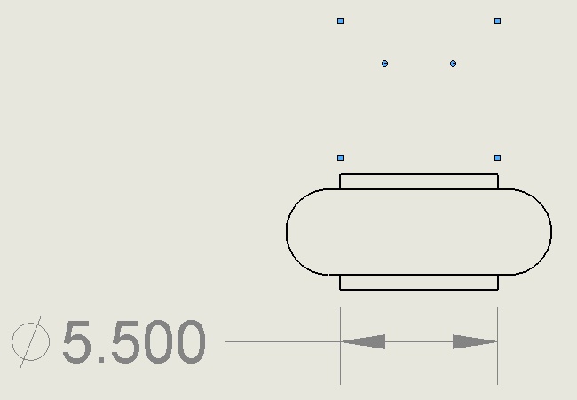

Ever seen this? I've just created a new set of sheet formats (A through E size, two different versions),
and when I switch to the new sheet formats on the A size drawings, adding dimensions now fails.
It seems to know how to figure them out, but doesn't display them after you select an entity.
When you "ok to place" them they don't seem to be placed - you can't box select them afterwards.
Now any dimension placed before you switch the sheet format stays and is editable as before.
The results look like this:
I tried loading different dimension styles. I checked out the layers. I thought maybe they're being
drawn in the beige color. No luck.
Any other things to try? How could a sheet format do this (particularly if I do the same
sheet format edits a dozen times, yet only cause this twice).
The alternative is to redo the sheet formats for the ones failing, but I hope there's
a setting some place that can correct that.
