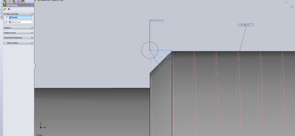

Hi there,
I am trying to create a thread in Solidworks 2011 using the helix and swept cut commands. I followed this tutorial (Solidworks modelling of M10 bolt a simple demo to start with - YouTube ) step by step, but mine does not seem to be working. There is no preview when I do the sweep cut, even though I have the triangle and helix selected. It works if I use the circle sketch, just not the triangle for some reason.
Is there a step I am missing? I copied exactly what the Youtube video did (he used a triangle too) and his showed the preview and worked. When I try pressing the green check mark, I get the message "Swept operation failed to complete"
