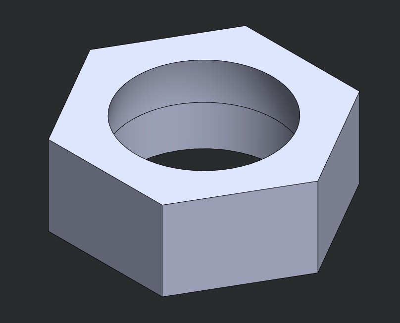

ISO view before cut

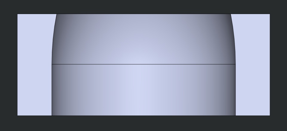

Section view of inside surface I am trying to have the cut follow

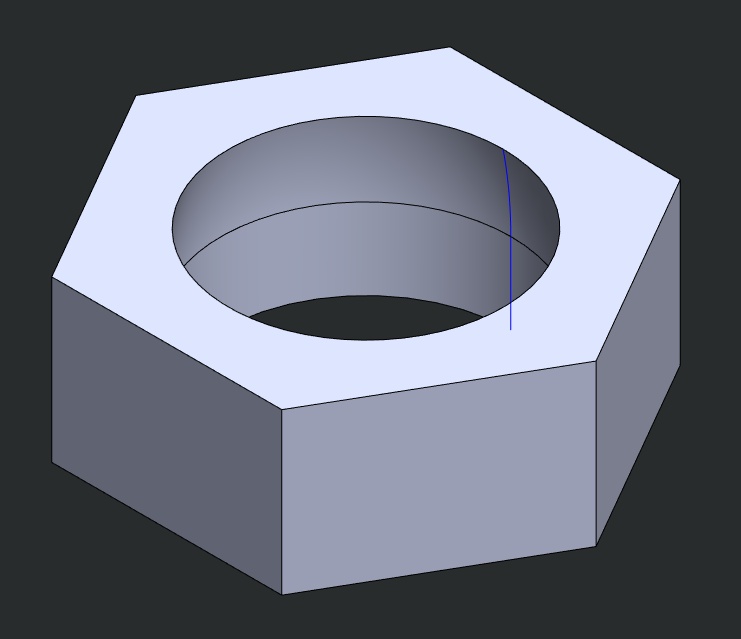

Guide curve

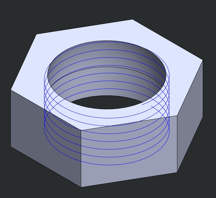

Helical curve

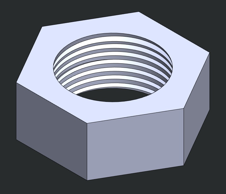

Cut without guide curve

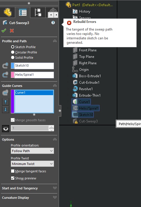

Error when I try to use guide curve
