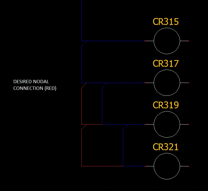

SWE how to get nodal indicators to display in ladder
Nodal indicators are great in defining the to/from routing for components but there are cases where they will throw an error.  One such case is attached.  Here I have relay coils along a ladder and I want the routing to show going into CR315, from CR315 to CR317, CR317 to CR319 and CR319 to CR321.   The way they are displayed in red would do that, however you cant draw it that way.  The only way to make it work is by staggering the connections as in blue. This is an issue when there are many connections to be made.  If they cant be connected as in blue, any terminal blocks can show the wrong devices or connection tables will also be wrong.  Wire/cabling Order is just as confusing to try to do this.  The techs who wire the panels actually prefer the way its drawn in red because it shows exactly how it is to be wired.
