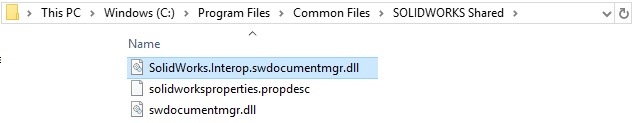

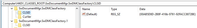

Hello,
After updating to SW 2018, I'm unable to GetPreviewBitmap in one of our desktop applications that uses the document manager. It is producing the following error. "Cannot create ActiveX component". I requested a 2018 new license key with
all the right privileges (swdocmgr_general, swdocmgr_previews, swdocmgr_geometry, swdocmgr_xml). I do believe everything is correct in the registry. Does anyone know why this is happening now or how to resolve? Thank you in advance.
