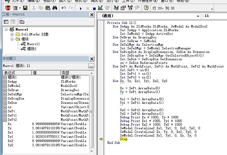

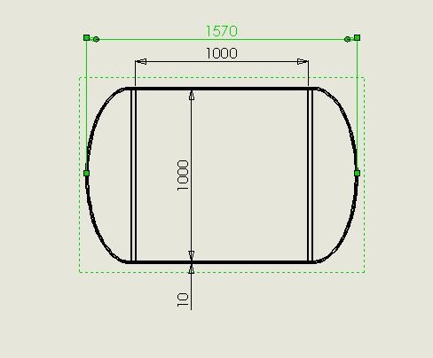

SwDim.ReferencePoints+MathPoint
Follow code, result is Error.
Help me .
How to use MathPoint and ReferencePoints?
Private Sub ll()
   Dim SwApp As SldWorks.SldWorks, SwModel As ModelDoc2
       Set SwApp = Application.SldWorks
       Set SwModel = SwApp.ActiveDoc
   Dim SwDraw As DrawingDoc
       Set SwDraw = SwModel
   Dim SwSelMgr As SelectionMgr
       Set SwSelMgr = SwModel.SelectionManager
   Dim SwDispDim As DisplayDimension, SwDim As Dimension
       Set SwDispDim = SwSelMgr.GetSelectedObject5(1)
       Set SwDim = SwDispDim.GetDimension
       ss = SwDim.ReferencePoints
   Dim SwPt As MathPoint, SwPt1 As MathPoint, SwPt2 As MathPoint
       Set SwPt = ss(0)
       Set SwPt1 = ss(1)
       Set SwPt2 = ss(2)
   Dim Xx, Yy, Xx1, Yy1, Xx2, Yy2
       Xx = SwPt.ArrayData(0)
       Yy = SwPt.ArrayData(1)
       Xx1 = SwPt1.ArrayData(0)
       Yy1 = SwPt1.ArrayData(1)
       Xx2 = SwPt2.ArrayData(0)
       Yy2 = SwPt2.ArrayData(1)
       Debug.Print Xx * 1000, Yy * 1000
       Debug.Print Xx1 * 1000, Yy1 * 1000
       Debug.Print Xx2 * 1000, Yy2 * 1000
       SwModel.CreateLine2 Xx1, Yy1, 0, Xx2, Yy2, 0
       SwModel.CreateLine2 Xx, Yy, 0, Xx2, Yy2, 0
       SwModel.CreateLine2 Xx1, Yy1, 0, Xx, Yy, 0
End Sub
