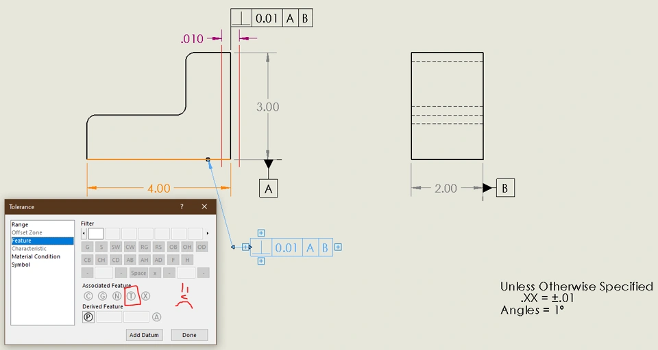

Encountered an issue with my SolidWorks where the tolerance modifier symbol for Tangent Plane is greyed out regardless of previously specified information within the feature control frame.
Saw one user saw this issue as well, but was in a different situation with SW2025. Might have been a carried over issue?
I am here using SW2024 SP5.0 (32.5.0.0048)
Below is a hastily thrown together example showing the tangency option is greyed out.
