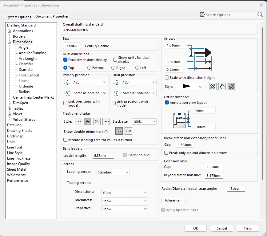

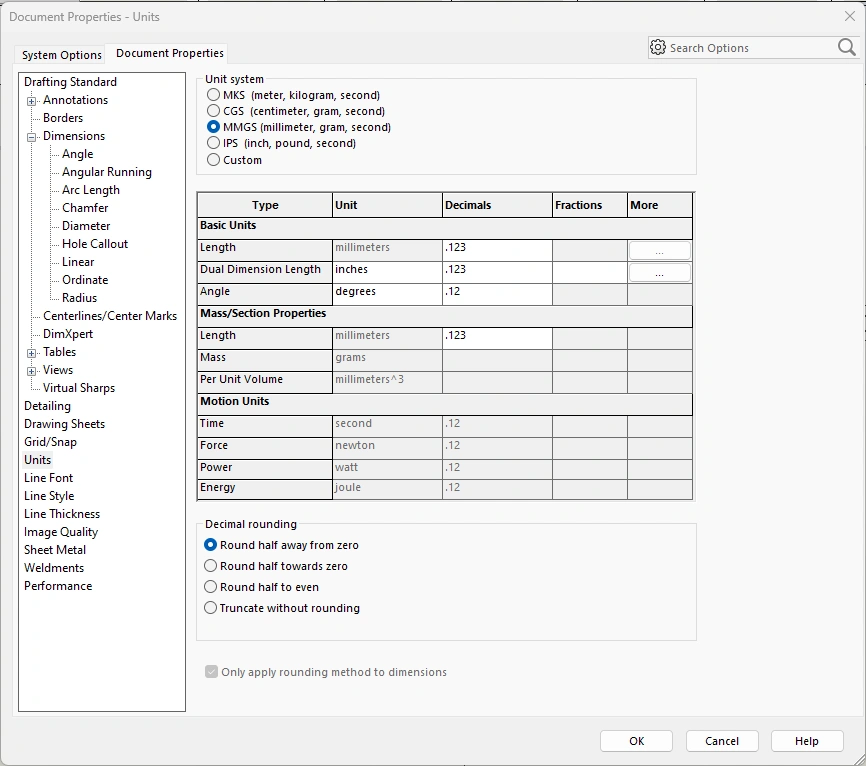

I need to create a drawing with dual dimensions, the units system for the drawing is MMGS because the customer wants inspection done in millimeters, while dimensions in inches are needed for our machinists.

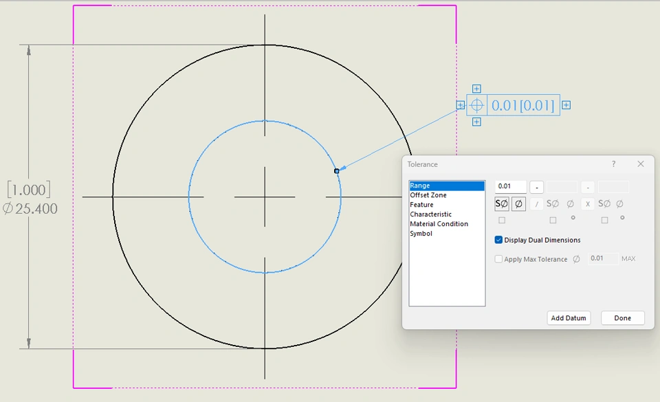

Here's a mockup drawing showing the issue on my system where dual dimensioning works for linear dimensions on the left, but on the right where I have dual dimensions turned on for the GD&T FCF, it gives both dimensions in mm (0.01 [0.01]) even though my document settings are for dual dimensions to be shown in inches.
Is there another setting to control the dual dimensions units for the FCF? If I could manually overide the dimensions in the block as you can for standard drawing dimensions I would do that as a workaround but I can't do that either.

Document Properties - Dimensions
Document Properties - Units
