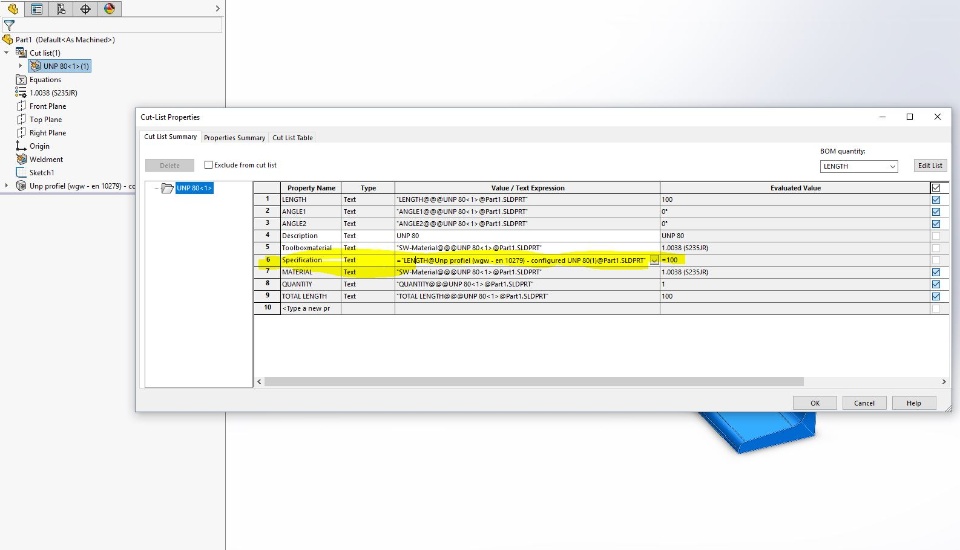

We have a problem and we cant figure it out. It did work correct in SW 2017 and previous versions, but is doesnt in SW2018.

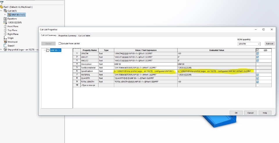

We have a cut list property which evaluates to the length of the profile. In previous versions the length was displayed. But after updating 2018 is gives a text string as result.

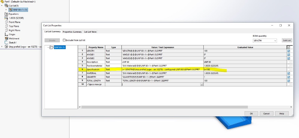

The strange thing is, when i delete one character in te Value/text expression the value is displayed correct.
Is this a bug, or is some setting changed in SW2018? Are more people having similar problems? And does somebody know how to fix it?
