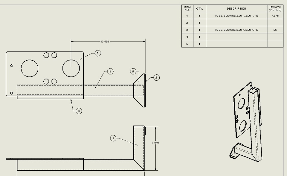

Just installed SW2017SP1 this week, my first weldment was done today. When I placed the Cutlist in the drawing I noticed there are only 5 'parts' showing, not the six I see.

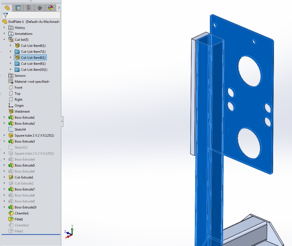

It appears 'Cut-List-Item8' has merged bodies with the large plate with the holes. But AFAIK one can not merge these 'parts/bodies'
Any idea how to break this link so the large plate will show in the drawing cutlist?
