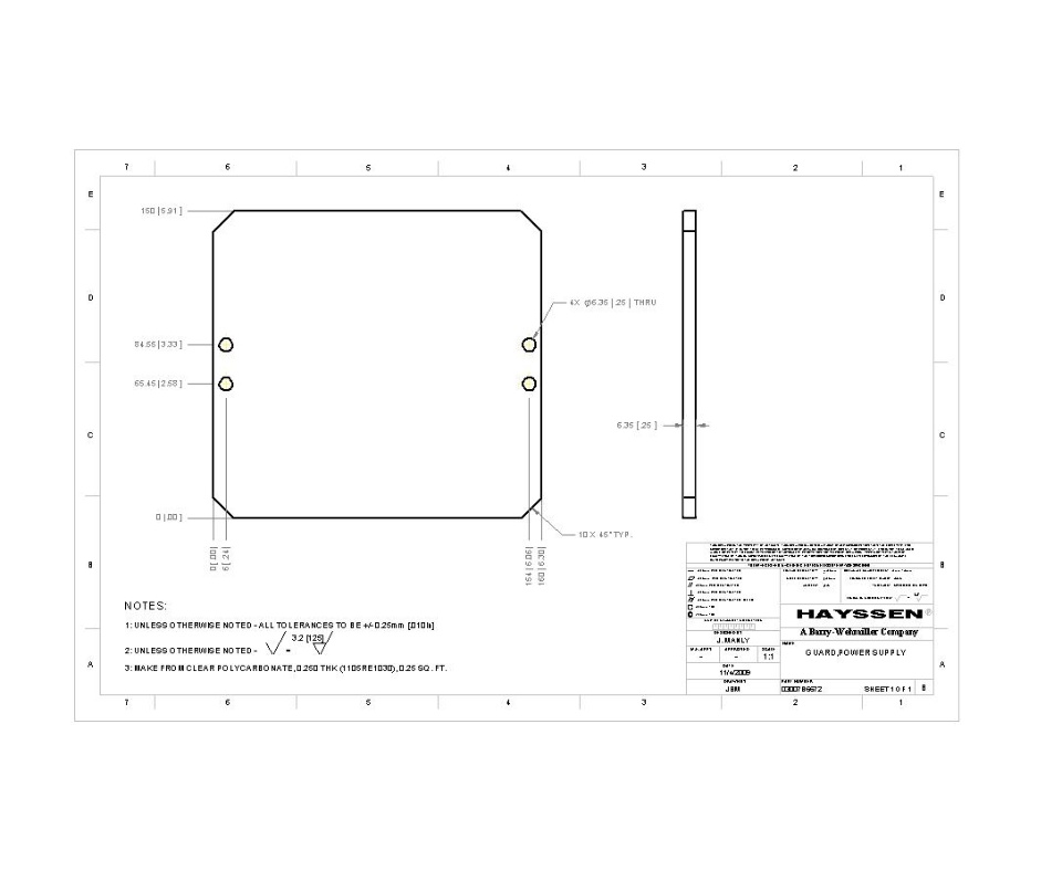

Hi all:
We recently upgraded to SW2009.  Afterward, certain annotations show up in yellow; specifically, model dimensions, GD&T symbols, BOM tables, center marks, center lines, etc.  Applied dimensions and notes are black, as expected.  Is there a setting for this, or is this possibly a graphics driver issue?  I searched through the color settings and didn't find anything helpful.  We previously ran SW2007 and did not experience this problem.  We have verified that our graphics cards & driver are no longer supported.  Hopefully, we're getting new workstations soon, but I find the yellow difficult to see, and irritating.
If this is known to be a driver issue, is there a workaround?
