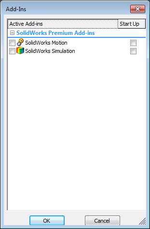

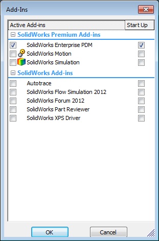

When executed, SolidWorks starts as expected, but several add-ins are missing. If I start SW manually, and then look at Tools..Add Ins, I see this:
If I start SW using the code above I see this:
I really need the two to be identical. Any thoughts?
