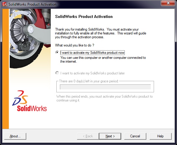

2) A license activation screen comes up (like it does the first time you install SW) and it wants me to activate my copy (which I already did a year or so ago).  I click "Next" (see picture)

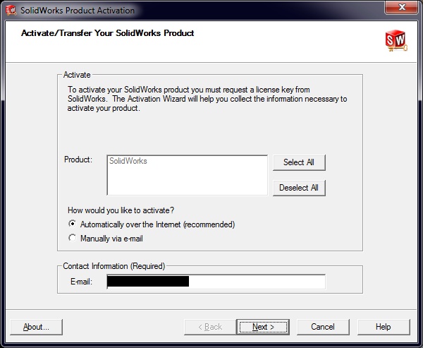

3) It lets me choose which products to activate (see picture).  I click "Next"

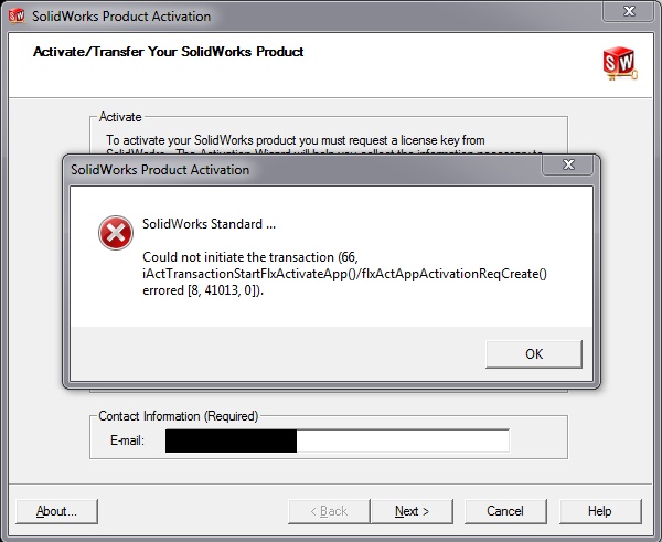

4) The error comes up: "Could not initiate the transaction (66,iActTransactionStartFlxActivateApp()/flxActAppActivationReqCreate()errored [8, 41013, 0])."  (See picture).  I click OK.

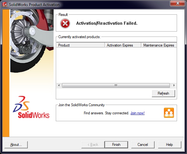

5) A screen comes up and says that activation/registration failed.  When I click "Finish," it quits the program.
6) I tried both methods (clicking to activate either via the internet or via email from Step 3), but I always get the same error.
