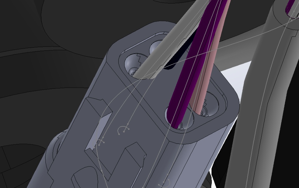

Is there a way to control the wire axis length from Cpoints in a connector? I've created Cpoints inside my connector from where the wire would start and a Cable Cpoint at a reasonable distance from the back of the connector housing. However when routing harnesses, the wires bend early towards the Cable Cpoint as the attached image shows and cross through the housing. when creating Cpoints from manufacturer part through the routing library manager wizard I only have the option to select vertices but I notice that when selecting general Cpoints that you can amend the stub length. Is there a way to do that for manufacturer parts? Better yet. Can I get the routing tool to follow the Cpoint axis a specified length when it routes?

Nope.  The CPoints stay where they are.  The stub length is the straight amount going in the direction of the CPoint and is part of the sketch spline.  In your picture you can see the small straight at the end of the sketch spline.  This is the stub length.  There is another value called Additional Internal Wire Length that will "add" extra wire to the end if needed but it is not shown in the sketch, just added in the length calculation.

I believe if you open the model part file you can right-click the CPoint to edit the feature and set the "stub length" to the value you want.  Changing this will only affect new routes.  In an existing route you can grab the point close to the end of the route sketch and drag it out and/or add a dimension.  This will make the straight part at the end longer and the wires will look more accurate.

Thank's Steven. So really, I need to place all my Cpoints at the face of the connector housing exit and add add a stub length if I want to get accurate wire lengths?
